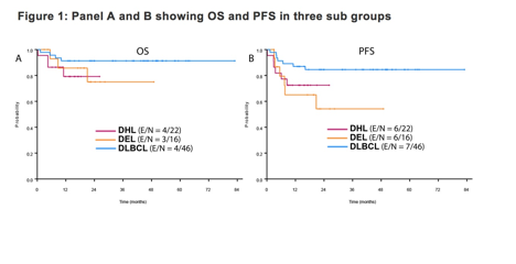

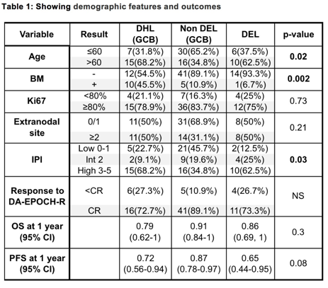

Results: We identified 233 high risk DLBCL patients treated with (DA) EPOCH-R. After filtering the data to identify patients which were included in our three groups, we identified 22 patients with DHL (GCB), 46 patients with non DEL (GCB), and 16 with DEL. The demographic features and outcomes are mentioned in the table 1 below. The DHL group had more frequent bone marrow (BM) involvement, and the DHL and DEL groups were more frequently age >60 years and high IPI in comparison to the non DEL GCB group. The CR rate, OS and PFS at 1 year were not significantly different between these three groups. Figure 1 highlights the OS (A) and PFS(B) results of each group.
结果:我们找出了233位接受DA-EPOCH-R治疗的高危弥漫大B患者。经过数据过滤,我们确定了22位双重打击(GCB),46位非双重表达(GCB)和16位双重表达。统计学数据和结果见表1.双重打击组有较多的骨髓侵犯,双重打击组和双重表达组年龄普遍大于60岁,IPI与非双重表达(GCB)组更高。三个亚组1年的完全缓解率,总生存率和无进展生存率没有明显区别。

点评:MD Anderson癌症中心是全美排名第一的癌症中心,来自MD Anderson的经验一定会有很多人关注;这是一项回顾性研究,因此数据的说服力比不上前瞻性的随机临床试验;随访时间比较短,所以在总生存率上各组差别很小。不过,DA-EPOCH-R对双重打击所获得的70%以上的完全缓解率也足以令人刮目相看。
