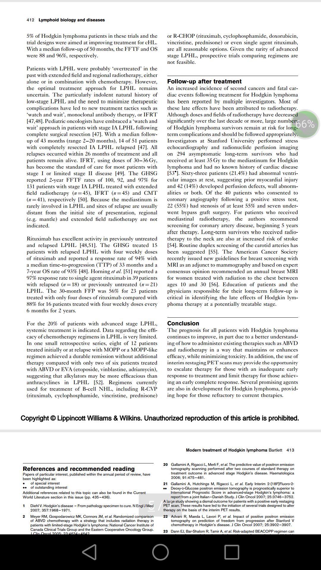

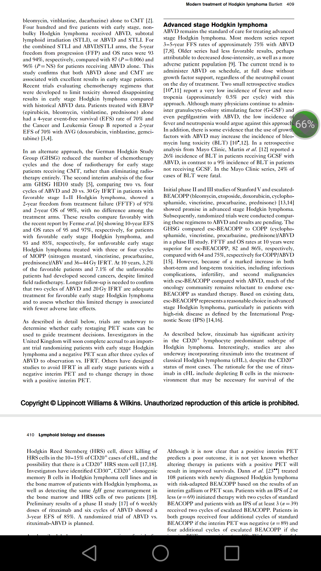

结节性淋巴细胞为主型霍奇金淋巴瘤(NLPHL)典型的免疫表型CD20+, 可以使用美罗华,但是 经典型霍奇金淋巴瘤(c HL)典型的免疫表型是CD20-,能否用美罗华呢?当时心怀疑虑,查了一些文献,确有cHL使用美罗华的,有学者认为,即使cHL中即使CD20-也可使用美罗华,理由是
1. depleting B cells in the microenvironment that may be necessary for survival of the Hodgkin Reed Sternberg (HRS) cell
2.direct killing of HRS cells in the 10–15% ofCD20+ cases of cHL,

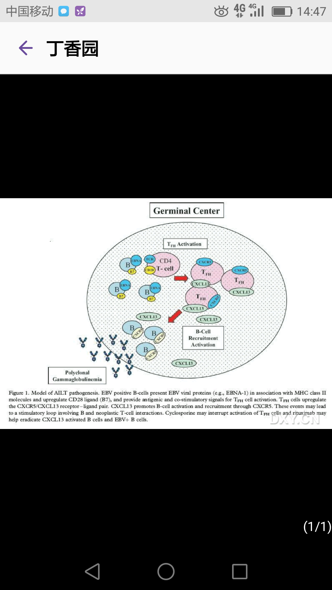

3 the possibility that there is a CD20+ HRS stem cell在临床研究方面,美罗华多用于一些复发难治的cHL,多为个案报道,德国有一个14例的研究,Based on the premise that B-cells may play a pathogenic role in AITL, Joly and colleagues recently described their experience with rituximab as an adjunct to CHOP (R-CHOP) in 9 elderly (age >60 years) patients with AITL.Using R-CHOP given at standard doses, they noted CR in 8 of 9 patients, with 1 patient having progressive disease. At a median follow-up of 12 months, they reported 2 relapses at 13 and 14 months, with the 7 remaining patients in continued clinical remission. However, it is noteworthy that 5 of the 9 patients studied also harbored significant numbers of EBV-positive large B-cells and a serum M-protein, suggesting the presence of a B-cell clone that might be uniquely sensitive to rituximab. Their findings have been extended to an ongoing phase II study of the GELA group.
AITL的临床表现往往有比较浓重的免疫异常色彩,如溶血性贫血,多克隆的高γ球蛋白血症等等,在多数病例中(75%)可见EBV(+)的细胞,但是EBV(+)的细胞大部分为B细胞,有些研究发现EBV也存在T细胞。EBV的感染率很高,即使有EBV+的B细胞,似乎对还没有标准治疗方案,再有B细胞EBV+和T细胞淋巴瘤有多大直接关系呢?当然有很多做B细胞永生化的就是用EBV进行体外转染的。即使杀掉B细胞,对肿瘤本身有什么好处呢?
cHL使用美罗华?似乎理由不够充分,cHL的RS没有CD20的表达,用美罗华的借口在哪里呢?消灭掉B细胞,理论上切断了肿瘤的细胞来源,但是对于已经瘤变的细胞,有用么?能消除么?如果用R结合其他方案,干掉所有的B细胞,客观上来说,既消灭了来源,又消灭了瘤细胞本身,但是cHL大家戏称如同治感冒一样,需要用那么昂贵的R么?
