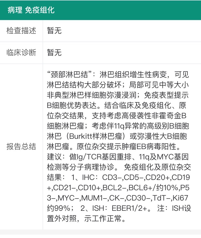

我的病情,派特分期2期,ipi 评分0分,骨髓流式没有侵袭,染色体没有问题。我的主治医生很强势的用R CHOEP,然后喊我六个疗程后移植。我自己的想法是用强一点的方案,后面不用移植!请大神帮我分析一下,感谢@橙色雨丝 @洪飞

NCCN指南是这么说的:Most common karyotype is MYC rearrangement as a sole abnormality. There is an uncommon variant of BL without MYC rearrangement but with 11q aberration (LBCL with 11q aberration [ICC]; HGBL with 11q aberrations [WHO5]). Optimum management of this rare subtype is undefined, though it is most often treated like typical BL。这种类型的最佳治疗路径待定,但大多数时候参照伯基特淋巴瘤来治疗。

谢谢大神,就是用DA EPOCH-R方案!
